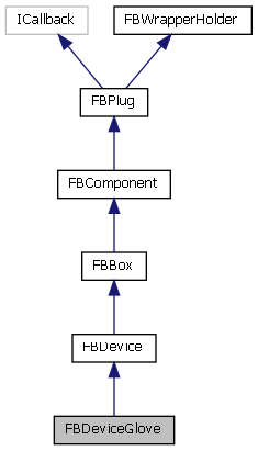

Base Glove class. More...
#include <fbcore.h>
Classes | |

| enum kHandModelPart |
| FBDeviceGlove | ( | const char * | pName, |
| HIObject | pObject = NULL |
Constructor.
| pName | Name of device. |
| pObject | For internal use only (default is NULL). |
protected |
Obtain the rotation animation node of a part of the hand model.
| pPartIndex | The hand part. |
protected |
Initialize the hand model geometry.
You should set the LeftHand property prior to using this method, so that the geometry gets initialized correctly. Also call this function if you changed the value of LeftHand property.
overridevirtual |
When recording, finish animation.
| pAnimationNode | Animation node to write information to. |
Reimplemented from FBDevice.
overridevirtual |
When recording, initialize animation.
| pAnimationNode | Animation node to read information from. |
protected |
Bring the vector in parameter to a valid angle range of rotation for a given part of the hand model.
The input vector should have relative values between 0.0 (min) and 1.0 (max). The output vector is an euler local rotation vector with limits applied. This vector can then be used to constraint the rotation of the hand part model.
| pVector | The vector to modify. |
| FBArrayTemplate<GloveChannel*> Channels |
| FBPropertyBool LeftHand |
