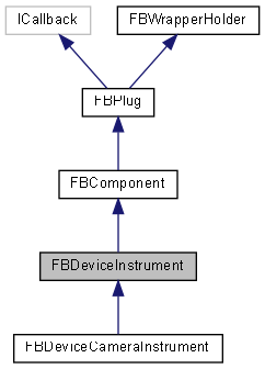

Instrument abstraction layer.
Definition at line 625 of file fbcore.h.
