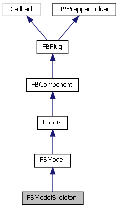

Inheritance diagram for FBModelSkeleton:
