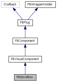

Scroll Box.
This class provides a layout that will be automatically managed with a scrollbar according to the specified width and height. This provides a way to add dynamic UI control.
Definition at line 1144 of file fbcontrols.h.
FBScrollBox | ( | ) |
Constructor.
FBLayout* GetContent | ( | ) |
Returns an empty layout in which you can add scrollable content.
void SetContentHeight | ( | int | pContentHeight | ) |
Sets the content height.
This zone will be available to be scrolled vertically.
pContentHeight | Content Height. |
void SetContentWidth | ( | int | pContentWidth | ) |
Sets the content width.
This zone will be available to be scrolled horizontally.
pContentWidth | Content Width. |
