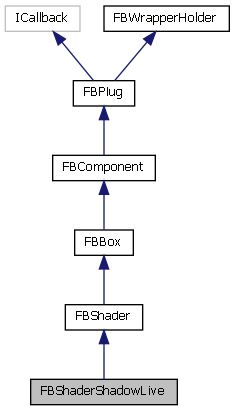

Shader Shadow Live class. More...
#include <fbshader.h>
Use the Live Shadow shader to apply real-time shadows to models. You can specify shadow intensity as well as the lights and objects that cast shadows in a scene.
There are two methods to create a FBShaderShadowLive object: using the FBShaderManager, or simply by instantiating a class object explicitely.
Sample C++ code:
Sample Python code:
Definition at line 880 of file fbshader.h.
| FBShaderShadowLive | ( | const char * | pName, |
| HIObject | pObject = NULL |
Constructor.
| pName | Name of shader. |
| pObject | Internal parent object to own shader (default is NULL). |
| FBPropertyListObject Lights |
List: List of light object which will produce shadows.
Definition at line 899 of file fbshader.h.
| FBPropertyBool LocalShadow |
Read Write Property: Creates an accurate projection of a shadow for each object.
Definition at line 894 of file fbshader.h.
| FBPropertyListObject Models |
List: List of object which when lighted will cast a shadow.
Definition at line 900 of file fbshader.h.
| FBPropertyShadowFrameType ShadowFrameType |
Read Write Property: Used to select the shadow calculation method.
Definition at line 897 of file fbshader.h.
| FBPropertyAnimatableDouble ShadowIntensity |
Read Write Property: Controls the darkness of shadows cast by a selected object.
Definition at line 893 of file fbshader.h.
| FBPropertyShadowType ShadowType |
Read Write Property: Indicate which shadow type is desired.
Definition at line 892 of file fbshader.h.
| FBPropertyDouble ShadowZOffset |
Read Write Property: Specifies the offset of the Live Shadow shader's plane from the original selected plane.
Definition at line 896 of file fbshader.h.
| FBPropertyBool UseGobo |
Read Write Property: Includes the gobo in the shadow map calculation.
Definition at line 895 of file fbshader.h.
