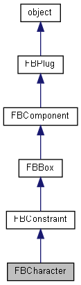

A character is the link between a motion source and a character model. More...
#include <pyfbsdk_generated.h>

Public Attributes inherited from FBConstraint | |
| bool | Active |
| Read Write Property: Active state. More... | |
| bool | Deformer |
| Read Write Property: Is a deformer constraint? More... | |
| str | Description |
| Read Write Property: Long description of constraint. More... | |
| bool | HasLayout |
| Read Write Property: Does the constraint have a layout? More... | |
| bool | Lock |
| Read Write Property: Lock state. More... | |
| FBAction | Snap |
| Function Property: Snap constraint. More... | |
| FBAnimatableDouble | Weight |
| Read Write Property: Weight of constraint. More... | |
Public Attributes inherited from FBBox | |
| bool | Animatable |
| Read Write Property: Is the box animatable. More... | |
| bool | Live |
| Read Write Property: Is live? More... | |
| bool | RecordMode |
| Read Write Property: Is recording? More... | |
| str | UniqueName |
| internal Unique name. More... | |
Public Attributes inherited from FBComponent | |
| FBListComponent | Components |
| List: List of components. More... | |
| str | LongName |
| Read Write Property: Name and namespace for object. More... | |
| str | Name |
| Read Write Property: Unique name of object. See sample: RemoveSuffixFromNameOfSceneElements.py. More... | |
| FBListComponent | Parents |
| List: Parents. More... | |
| FBManager | PropertyList |
| Read Only Property: Manages all of the properties for the component. More... | |
| bool | Selected |
| Read Write Property: Selected property. More... | |
| int | TypeInfo |
| Contains the Type information of the object. More... | |
Public Attributes inherited from FBPlug | |
| str | ClassGroupName |
| ClassGroupName of the object. More... | |
| int | TypeInfo |
| TypeInfo. More... | |
