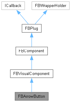

Creates a button which opens a layout to display content. More...
#include <fbcontrols.h>
Public Member Functions | |
| FBArrowButton () | |
| Constructor. | |
| void | SetContent (const char *pTitle, FBVisualComponent *pContent, int pContentWidth, int pContentHeight) |
| Sets the content to be hidden/shown by button. | |
When pushed a layout to display content (another control or a layout) is opened. A small arrow to the left of the button title, shows whether the content is shown (points down) or not (points to the title).
Definition at line 1120 of file fbcontrols.h.
