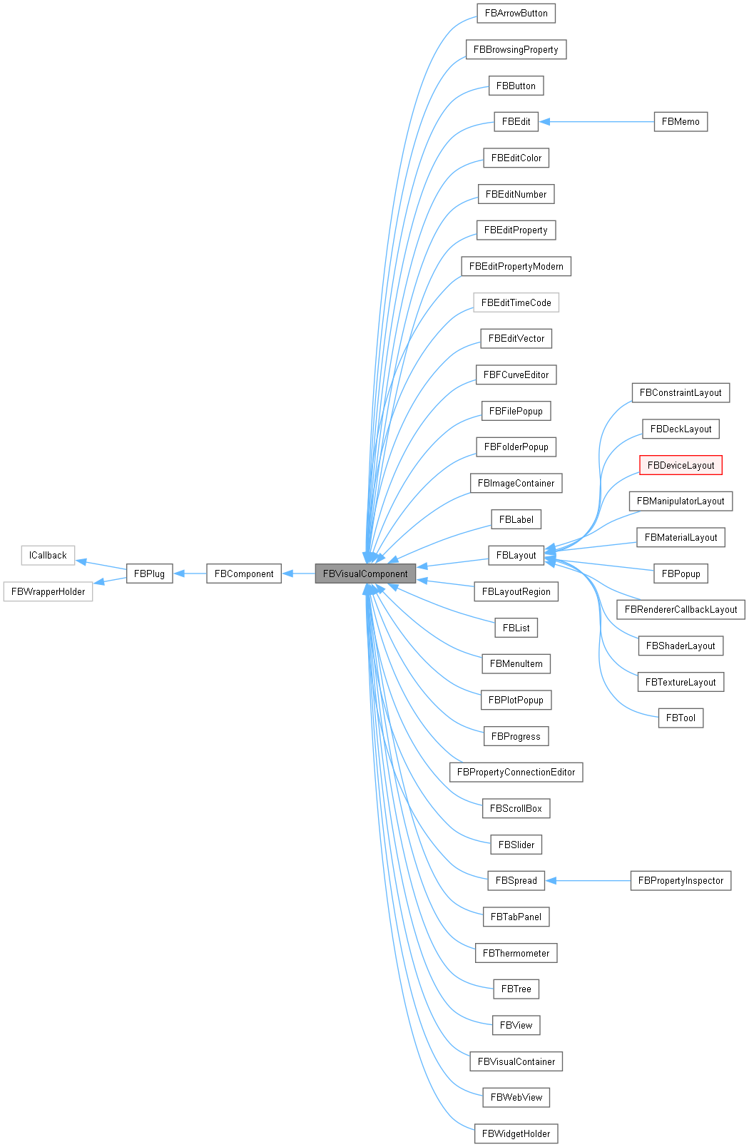

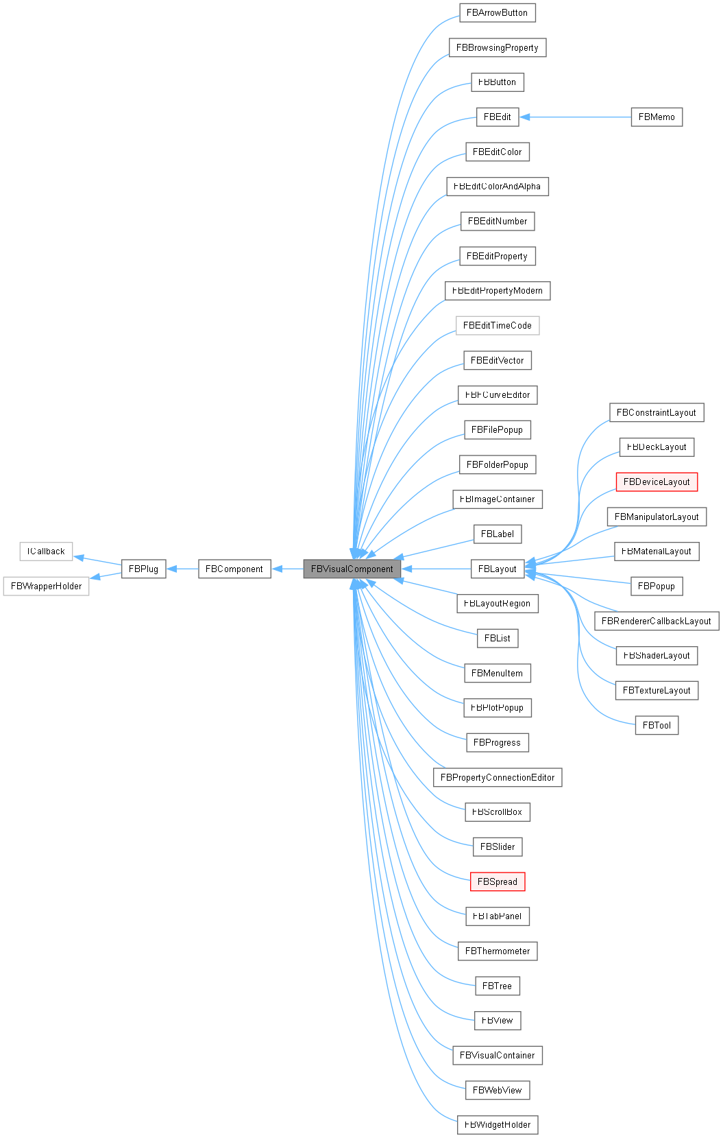

FBVisualComponent Class Reference
Visual Component base class. More...
#include <fbcontrols.h>
Inheritance diagram for FBVisualComponent:

Detailed Description
All of the user interface elements available in the SDK derive from this class.
Definition at line 312 of file fbcontrols.h.
