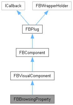

Inheritance diagram for FBBrowsingProperty:

Detailed Description
Property browsing.
Definition at line 2550 of file fbcontrols.h.
