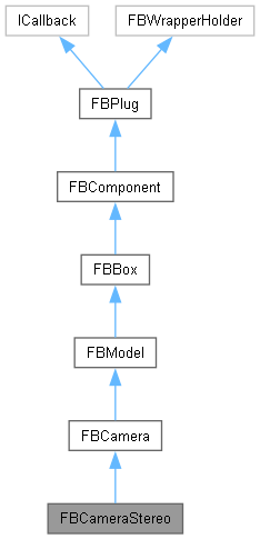

Public Member Functions | |
| FBCameraStereo (const char *pName, HIObject pObject=NULL) | |
| Constructor. | |
Public Member Functions inherited from FBCamera | |
| FBCamera (const char *pName, HIObject pObject=NULL) | |
| Constructor. | |
| void | GetCameraMatrix (FBMatrix &pMatrix, FBCameraMatrixType pType, FBEvaluateInfo *pEvalInfo=NULL) |
| Obtains the camera's matrix. | |
| FBVector4d | InverseProjection (int pX, int pY, double pDistanceFromCamera, bool pRelativeToViewport=false) |
| Returns the world coordinates based on screen coordinates and input distance from the camera. | |
| void | GetAnimatableFarPlane (FBPropertyAnimatableDouble *pProp) |
| void | GetAnimatableNearPlane (FBPropertyAnimatableDouble *pProp) |
