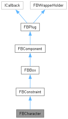

A character is the link between a motion source and a character model. More...
#include <fbcharacter.h>
These classes are under development and may change dramatically between versions. This class exposes part of the functionality associated with a Character. A character can possess a number of potential sources at the same time, such as an actor and another character, but with only one active at any given time. Before setting the InputType to the desired value, one must make sure to have previously set either the InputCharacter or the InputActor.
To obtain the list of characters present in a scene, you need to create an instance of class FBSystem, to obtain the current scene. The FBScene object holds the list of characters in the property Characters.
The current character selected in the Character tool can be obtained via the FBApplication object.
Definition at line 1393 of file fbcharacter.h.
