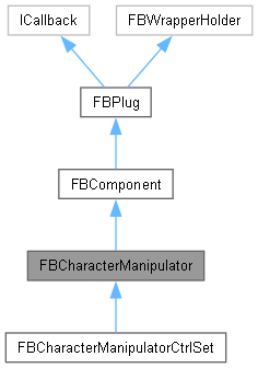

| | FBCharacterManipulator (const char *pName, HIObject pObject=NULL) |
| | Constructor.

Character Manipulator class.
Definition at line 165 of file fbcharactermanipulator.h.
