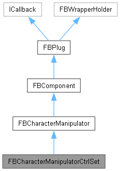

FBCharacterManipulatorCtrlSet Class Reference
Constraint class. More...
#include <fbcharactermanipulator.h>
Inheritance diagram for FBCharacterManipulatorCtrlSet:
Public Member Functions
