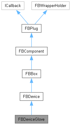

FBDeviceGlove Class Reference
Base Glove class. More...
#include <fbcore.h>
Inheritance diagram for FBDeviceGlove:
