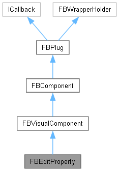

Property editor widget. More...
#include <fbcontrols.h>
Public Member Functions | |
| FBEditProperty () | |
| Constructor. | |
This widget allows users to edit the values of a property without having to manually customize the GUI depending on the type of the property being edited.
SDK objects can have three types of properties:
Another limitation of this widget is that it can only display non hidden internal properties. To get around this issue, the property flag can be changed to unhide it. Doing so will also cause the property to be visible via the property tool.
Definition at line 2495 of file fbcontrols.h.
| FBEditProperty | ( | ) |
Constructor.
| FBPropertyInt CaptionSize |
Read Write Property: Indicate how much width should the Property Editor reserve for displaying the property name.
Definition at line 2508 of file fbcontrols.h.
| FBPropertyDouble LargeInc |
Read Write Property: Indicate the large increment applied when click-draging on the property value (usually left-click-dragging)
Definition at line 2506 of file fbcontrols.h.
| FBPropertyDouble Precision |
Read Write Property: Used to specify the width and precision of the value shown. A value of 7.2 indicates to show at minimum 7 numbers, with 2 decimals.
Definition at line 2507 of file fbcontrols.h.
| FBPropertyReference Property |
Read Write Property: Property to edit. Set to NULL to disable.
Definition at line 2501 of file fbcontrols.h.
| FBPropertyDouble SliderMax |
Read Write Property: Should the property be editable using a slider, set the maximum value atainable with the slider.
Definition at line 2504 of file fbcontrols.h.
| FBPropertyDouble SliderMin |
Read Write Property: Should the property be editable using a slider, set the minimum value atainable with the slider.
Definition at line 2503 of file fbcontrols.h.
| FBPropertyDouble SmallInc |
Read Write Property: Indicate the small increment applied when click-draging on the property value (usually right-click-dragging)
Definition at line 2505 of file fbcontrols.h.
