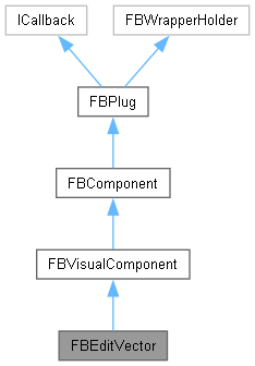

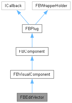

Vector edit widget. More...
#include <fbcontrols.h>

Vector edit widget.
Definition at line 1285 of file fbcontrols.h.
