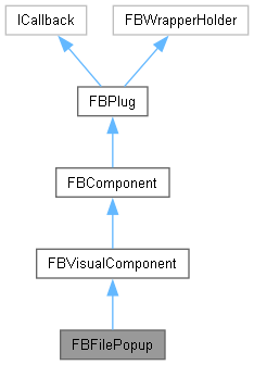

File Popup (for open/save). More...
#include <fbcontrols.h>
Public Member Functions | |
| FBFilePopup () | |
| Constructor. | |
| virtual bool | Execute () |
| Execute file popup. | |
