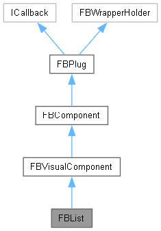

List of items.
Definition at line 1324 of file fbcontrols.h.
| FBList | ( | ) |
Constructor.
virtual |
Returns whether or not the item pIndex is currently selected.
| pIndex | Index to see if select or not. |
virtual |
Set the current selected state of item at pIndex to pSelected.
| pIndex | Index to affect item at. |
| pSelected | State to set item at pIndex to. |
| FBPropertyBool ExtendedSelect |
Read Write Property: Extended selection state?
Definition at line 1334 of file fbcontrols.h.
| FBPropertyInt ItemIndex |
Read Write Property: Current item index.
Definition at line 1332 of file fbcontrols.h.
| FBPropertyStringList Items |
List: Names of items in list.
Definition at line 1330 of file fbcontrols.h.
| FBPropertyBool MultiSelect |
Read Write Property: Can multiple items be selected?
Definition at line 1333 of file fbcontrols.h.
| FBPropertyEvent OnChange |
Event: List changed.
Definition at line 1337 of file fbcontrols.h.
| FBPropertyEvent OnDragAndDrop |
Event: Drag and drop event.
Definition at line 1338 of file fbcontrols.h.
| FBPropertyListStyle Style |
Read Write Property: Style or direction of list.
Definition at line 1335 of file fbcontrols.h.
