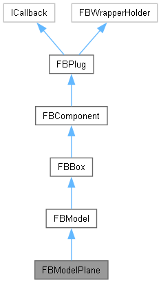

Plane model class. More...
#include <fbmodel.h>
Public Member Functions | |
FBModelPlane (const char *pName, HIObject pObject=NULL) | |
Constructor. | |
FBModel (const char *pName, HIObject pObject=NULL) | |
Constructor. | |
