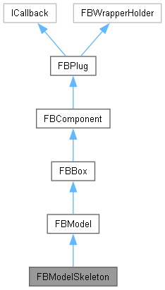

| | FBModelSkeleton (const char *pName, HIObject pObject=NULL) |
| | Constructor.
