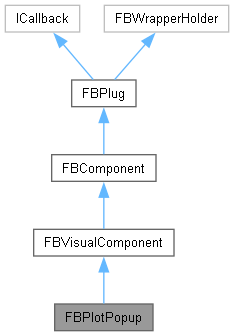

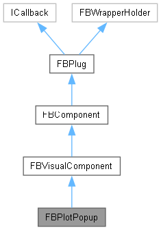

Plot Popup (for setting options only). More...

Public Member Functions inherited from FBVisualComponent | |

Public Member Functions inherited from FBComponent | |

Public Member Functions inherited from FBWrapperHolder | |
