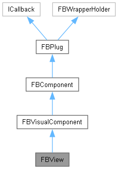

FBView Class Reference
Generic view. More...
#include <fbcontrols.h>
Inheritance diagram for FBView:
