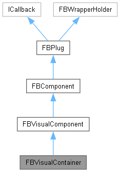

Used to create a container for a tool UI.
Definition at line 1689 of file fbcontrols.h.
