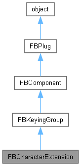

Objects Grouping class.
This class is an interface to manipulate object's grouping in the scene.
See sample: CreateCharacterExtensionOnSelectedObject.py.
