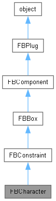

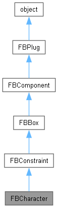

Inheritance diagram for FBCharacter:

- Public Attributes inherited from FBConstraint
bool Active
 Read Write Property: Active state.
bool Deformer
 Read Write Property: Is a deformer constraint?
str Description
 Read Write Property: Long description of constraint.
bool HasLayout
 Read Write Property: Does the constraint have a layout?
bool Lock
 Read Write Property: Lock state.
FBAction Snap
 Function Property: Snap constraint.
FBAnimatableDouble Weight
 Read Write Property: Weight of constraint.
- Public Attributes inherited from FBBox
bool Animatable
 Read Write Property: Is the box animatable.
bool Live
 Read Write Property: Is live?
bool RecordMode
 Read Write Property: Is recording?
str UniqueName
 internal Unique name.
- Public Attributes inherited from FBComponent
FBListComponent Components
 List: List of components.
str LongName
 Read Write Property: Name and namespace for object.
str Name
 Read Write Property: Unique name of object. See sample: RemoveSuffixFromNameOfSceneElements.py.
FBListComponent Parents
 List: Parents.
FBManager PropertyList
 Read Only Property: Manages all of the properties for the component.
bool Selected
 Read Write Property: Selected property.
int TypeInfo
 Contains the Type information of the object.
- Public Attributes inherited from FBPlug
str ClassGroupName
 ClassGroupName of the object.
int TypeInfo
 TypeInfo.
