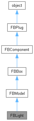

FBLight Class Reference
Light class. More...
#include <pyfbsdk_generated.h>
Inheritance diagram for FBLight:
