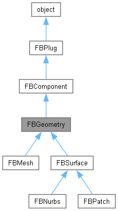

FBGeometry Class Reference
Geometry class. More...
#include <pyfbsdk_generated.h>
Inheritance diagram for FBGeometry:
