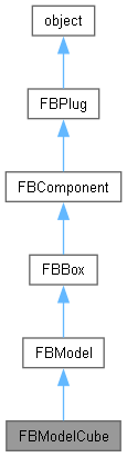

FBModelCube Class Reference
Cube model class. More...
#include <pyfbsdk_generated.h>
Inheritance diagram for FBModelCube:
