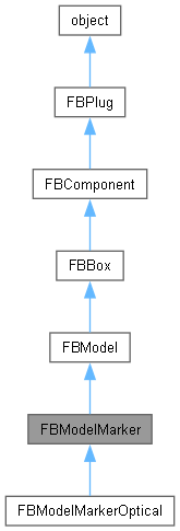

FBModelMarker Class Reference
Model marker class. More...
#include <pyfbsdk_generated.h>
Inheritance diagram for FBModelMarker:

Detailed Description
Model marker class.
See sample: FBCamera.py.
