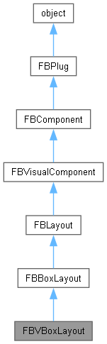

This class manages a FBBoxLayout Vertical (see FBBoxLayout for documentation on how to Add/Remove control). More...
Add method specify the fixed height of a control.
See samples: BoxCustomParams.py, BoxLayout.py, List.py, TutorialBox.py.
| FBVBoxLayout | ( | floworientation | ) |
floworientation: FBAttachType.kFBAttachTop : all controls added from top to bottom FBAttachType.kFBAttachBottom: all controls added from bottom to top
