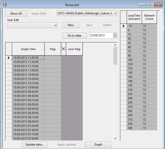

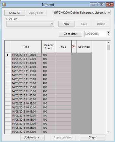

Example of Spatial time series data grid (forecast)

Element Count
Available for spatial time series only.
Displays the number of elements associated with each time.

Forecast data
Forecast streams are different in that each forecast stream has a series of forecast origins (on the left of the window) and each of these forecast origins has a series of time series data points, called forecast data (on the right of the window).
Item
Description
Origin Time
Data point timestamp.
Flag
A text flag that is currently used only for identifying imported values that are outside the minimum and maximum thresholds e.g. >10 m/s or >3.000000 in/day.
Exclude data point
To be used to mark the data point as excluded (Exclude data pointcolumn), indicating that it should not be used for the simulation.
User Flag
Originally greyed out, this field can be used to set or edit the data point flag.
Lead time
Available for spatial time series data only.
Data point timestamp for the forecast data point.
Element Count
