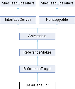

BaseBehavior Class Reference
All behaviors must inherit from this base class. More...
#include <C:/adskgit/3dsmax/3dsmax/3dswin/src/maxsdk/include/CS/bhvr.h>
Inheritance diagram for BaseBehavior:
