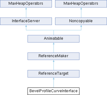

Inheritance diagram for BevelProfileCurveInterface:
