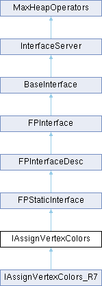

Inheritance diagram for IAssignVertexColors:
