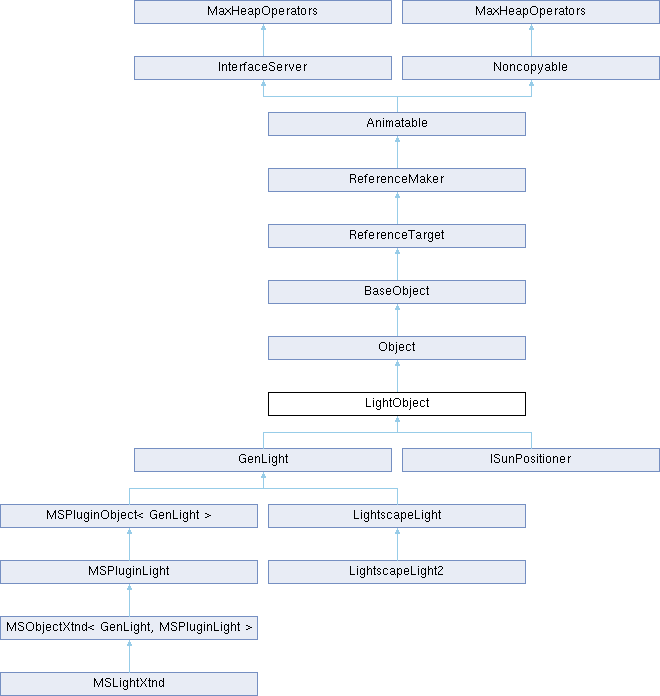

Inheritance diagram for LightObject:

Detailed Description
This is the base class from which plug-in lights may be derived.
See also
Class Object, Class ObjLightDesc, Class Interval, Class Texmap.
Member Function Documentation
◆ SuperClassID()
SClass_ID SuperClassID ( )
inlinevirtual
Retrieves a constant representing the type of the plugin.
Returns
A super class id that uniquely identifies the type (category) of the plugin. Note that several plugin classes can be of the same type, thus return the same super class id. Plugins are uniquely identified by their class ids.
See also
SClass_ID
Implements Animatable.
3523{ return LIGHT_CLASS_ID; }
