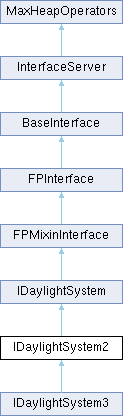

Inheritance diagram for IDaylightSystem2:
