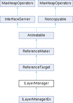

ILayerManager Class Referenceabstract
This class is an interface to the layer manager. More...
#include <C:/adskgit/3dsmax/3dsmax/3dswin/src/maxsdk/include/ilayermanager.h>
Inheritance diagram for ILayerManager:
