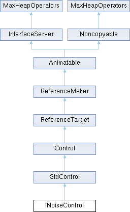

INoiseControl Class Referenceabstract
#include <C:/adskgit/3dsmax/3dsmax/3dswin/src/maxsdk/include/istdplug.h>
Inheritance diagram for INoiseControl:

Detailed Description
See also
Class Control.
Description:
This class provides access to noise controller's parameters. All noise controllers are derived from this class.
All methods of this class are implemented by the system.
