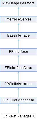

IObjXRefManager18 Class Referenceabstract
This interface extends IObjXRefManager8 interface. More...
#include <C:/adskgit/3dsmax/3dsmax/3dswin/src/maxsdk/include/XRef/iXRefObjMgr8.h>
Inheritance diagram for IObjXRefManager18:
