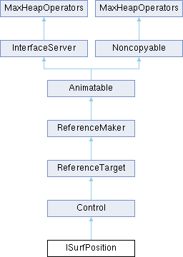

ISurfPosition Class Referenceabstract
#include <C:/adskgit/3dsmax/3dsmax/3dswin/src/maxsdk/include/istdplug.h>
Inheritance diagram for ISurfPosition:
Public Member Functions
virtual void SetSurface (INode *node)=0
