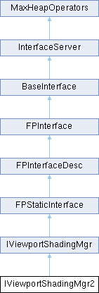

IViewportShadingMgr2 Class Referenceabstract
Extends class IViewportShadingMgr. More...
#include <C:/adskgit/3dsmax/3dsmax/3dswin/src/maxsdk/include/IViewportShadingMgr.h>
Inheritance diagram for IViewportShadingMgr2:
