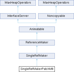

SingleRefMakerPatchMtl Class Reference
#include <C:/adskgit/3dsmax/3dsmax/3dswin/src/maxsdk/include/patchobj.h>
Inheritance diagram for SingleRefMakerPatchMtl:
Public Member Functions
 SingleRefMakerPatchMtl ()
 ~SingleRefMakerPatchMtl ()
RefResult NotifyRefChanged (const Interval &changeInt, RefTargetHandle hTarget, PartID &partID, RefMessage message, BOOL propagate)
 By default handles REFMSG_TARGET_DELETED message only.
virtual void GetClassName (MSTR &s, bool localized=true) const override
 Retrieves the name of the plugin class.
