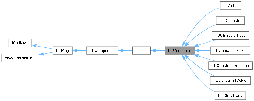

Base class for constraints. More...
#include <fbconstraint.h>
