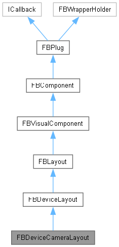

Camera device layout. More...
#include <fbdevicelayout.h>

| virtual bool | SizeRegion (const char *pName, int pW, int pH) |
| Change a region's size. | |
| virtual bool | RemoveRegion (const char *pName) |
| Remove a region. | |
| virtual bool | RenameRegion (const char *pOldName, const char *pNewName) |
| Rename a region. | |
