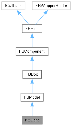

Light class. More...
#include <fblight.h>
