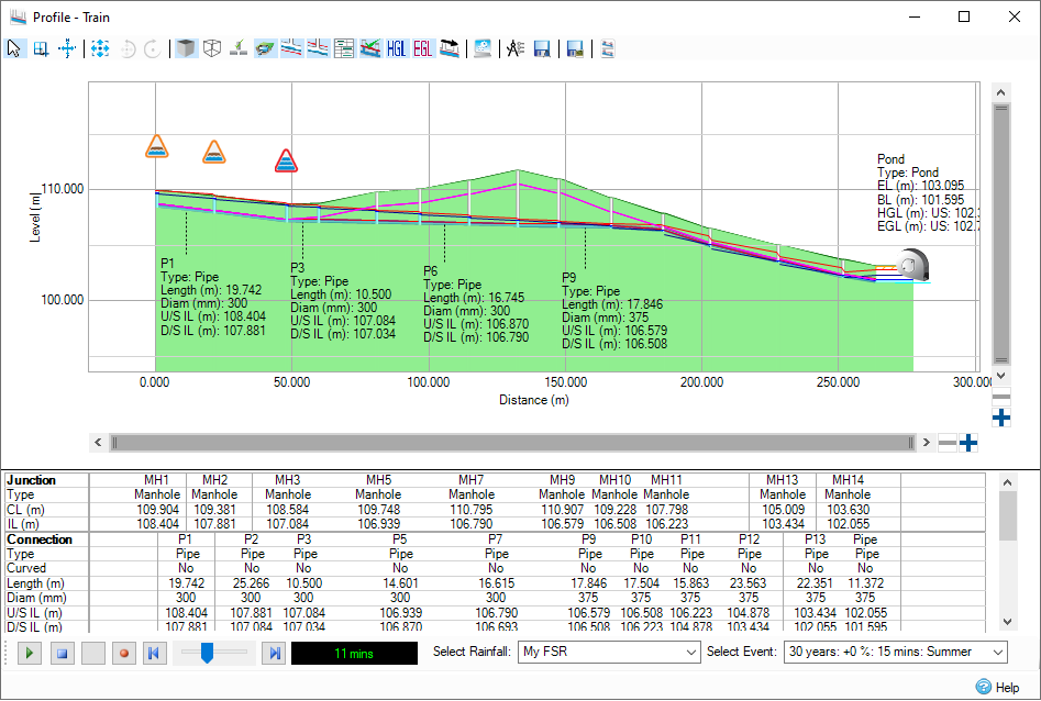

The Profile form allows given Flow Paths to be viewed in profile, and shows the relative lengths and levels of the various Connections, Stormwater Controls (SWC), Simple Junction and Manhole as well as the connections between them. The Summary table provides a quick look at the Profile items, allowing you to easily see and export important levels and sizes. As with the rest of InfoDrainage, the form is live and will update as the dimensions of elements shown are adjusted in the site. The profile can be exported to a CAD file, as well as most image formats.

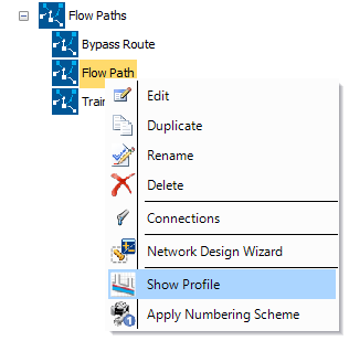

To view the profile for a given Flow Path, either double-click the flow path in the Tree View, or right-click and select Show Profile.

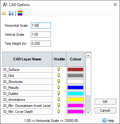

The CAD options icon will open the CAD options window.
The CAD Options form is used to set up the CAD Export options. From here, colours can be selected for each layer, as well as the HGL, and layers can be turned off, if not desired, using the light bulb icons. Scaling factors can be chosen for both horizontal and vertical axes, and a text height can be applied to ensure all text is a suitable height. Settings can be saved and re-loaded using the toolbar icons. The toolbar also contains a Reset button to revert all colours and settings to their default values.

Information is provided about the displayed profile items via Annotations. These are small snippets of information about the Junctions, Connections and SWC that can be seen at a glance. Annotations will only be displayed if there are enough space for them. You may need to zoom in to see the desired information, or else open the property window as described in Accessing Data Forms.

The summary table provides a concise view, containing a small summary of information about the profile items. Summary items are aligned with their respective items on the Profile. The summary table will be exported along with the profile only if it is currently visible.
The summary table can be resized using the splitter bar above it, as well as hidden with the Toolbar option. If the summary table is not large enough to display all the contained information, a scrollbar will be displayed.
Items within the Summary Table can be edited directly from the form. Double-clicking an entry will create a text box, allowing the value to be changed. Pressing Enter or clicking away will commit the change and create a new undo marker. Pressing Escape will cancel the edit, leaving the original value. This allows minor changes to be made seamlessly from within the Profile form.
