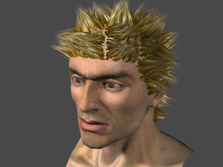

Clumped hair

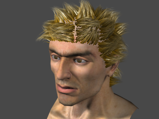

Scruffle=125.0

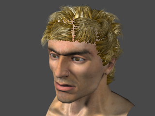

Scruffle=400.0
