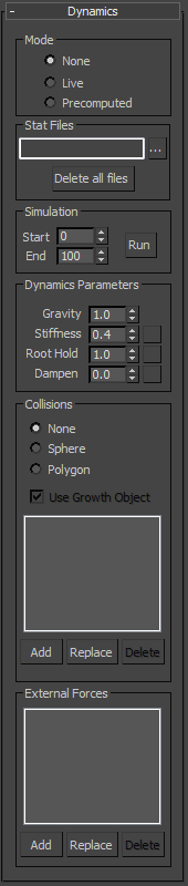

Interface
Mode group
Chooses the method Hair uses to generate dynamics. Live mode is suitable for experimentation, but for best results when rendering animation with Hair, use Precomputed mode.
- None Hair doesn't simulate dynamics.
Live Hair simulates dynamics interactively in the viewports, but doesn't generate animation keyframes or stat files for the dynamics. For best results with Live mode, turn off Display rollout
Display Hairs group
As Geometry.
For some methods of using live dynamics, see this procedure: Example: To view hair dynamics in real time.

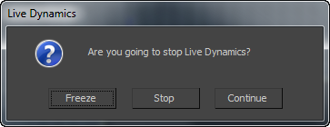

If you press Esc while using live dynamics, 3ds Max displays a dialog that asks whether you want to stop live dynamics. Both Freeze and Stop reset the mode to None, but Freeze freezes the hair in its current position. You can use this as a starting point for precomputed dynamics, or as a point from which you style the hair.
- Precomputed Lets you generate stat files for rendering dynamics-animated hair. Available only after setting a name and location for stat files (see following and To generate a precomputed dynamics simulation with Hair).
Stat Files group
Stat files let you record and play back a Hair-generated dynamics simulation. For a workflow example, see this procedure: To generate a precomputed dynamics simulation with Hair.
- Text field
Displays the path and file name for the stat files.
(ellipsis button) -
Click to choose a name prefix and location for stat files using the Save As dialog.
Hair adds a four-digit frame number (with leading zeroes) and the file name extension “.stat” to the name you provide (for example, hair_test0001.stat).
- Delete all files
Deletes stat files from the target directory. The files must have the name prefix you assigned using the ... button.
Tip: You can still use stat files even if you move them to another location. Follow this procedure:
Open the MAX file used to generate the stat files.
- On the
Modify panel
Dynamics rollout, click
(the ellipsis button).
- Use the Save As dialog to navigate to the directory with the stat files, and then click any stat file. Its name appears in the File Name field.
- Edit the File Name field to delete the four-digit extension after the stat file name. For example, if the stat file name is test0033.stat, delete the “0033” so that it reads test.stat.
- Click the Save button. The new stat file path appears in the Stat Files field.
Now, when you play or render the animation, Hair uses the stat files as originally generated.
Simulation group
Determines the extent of the simulation, and lets you run it. These controls become available only after you choose Precomputed mode and specify stat files in the Stat Files group. Set Start and End to the frames at which to begin and end the simulation, and then click the Run button. 3ds Max then computes the dynamics and saves the stat files.
- Start
The first frame to consider in calculating the simulation.
- End
The final frame to consider in calculating the simulation.
- Run
Click to run the simulation and generate the stat files within the frame range indicated by Start and End.
To abort a simulation while it's running, click Cancel on the status bar.
Dynamics Parameters group
These controls specify the basic parameters for the dynamics simulation. The Stiffness, Root Hold, and Dampen values can be mapped: click the map button to the right of the spinner to assign a map. Grayscale values in the map multiply the parameter's value at that hair location.
You can apply a map to the Stiffness, Root Hold, and Dampen parameters. To assign a map, click the map button to the right of the control, and use the Material/Map Browser to choose a map.
You can also drag and drop a map from a Material Editor sample slot. If the Slate Material Editor is open, you can drag from a map node's output socket, then drop onto this button. You can also drag and drop from a map button in the Material Editor or anywhere else in the 3ds Max interface. When you drop a map onto the map button, a dialog asks if you want the map to be a copy (independent) or an instance of the source map.
- Gravity
Lets you specify a force that moves hair vertically in world space. Negative values pull hair up while positive values pull it down. To cause hair not to be affected by gravity, set the value to 0.0. Default=1.0. Range=–999.0 to 999.0.
- Stiffness
Controls the magnitude of the effect of dynamics. If you set Stiffness to 1.0, the dynamics will have no effect. Default=0.4. Range=0.0 to 1.0.
- Root Hold
Comparable to stiffness, but affects the hair only at the roots. Default=1.0. Range=0.0 to 1.0.
- Dampen
Dynamic hair carries velocity forward to the next frame. Increasing dampening increases the amount by which these velocities are diminished. Thus, a higher Dampen value means that hair dynamics will be less active (the hair can also start to get “floaty”). Default=0.0. Range=0.0 to 1.0.
Collisions group
Use these settings to determine which objects hair collides with during a dynamic simulation and the method by which collision is calculated.
- None Collisions are not considered during the dynamic simulation. This can cause the hair to penetrate its growth object as well as other objects it comes into contact with.
- Sphere Hair uses a spherical bounding box to calculate collisions. This method is faster because it requires less computation, but can cause inaccurate results. It's most effective when the hair is seen from a distance.
- Polygon Hair considers each polygon in the collision objects. This is the slowest method, but the most accurate.
- Use Growth Object
When on, hair collides with the growth (mesh) object.
- Objects list
Lists the names of scene objects with which hair should collide.
- Add
To add an object to the list, click Add and then click the object in a viewport.
- Replace
To replace an object, highlight its name in the list, click Replace, then click a different object in a viewport.
- Delete
To remove an object, highlight its name in the list, then click Delete.
External Forces group
This group lets you specify space warps that will affect the hair during the dynamics simulation. For example, you can add a Wind space warp to cause the hair to be blown by a breeze.
- Objects list
Lists the names of forces that dynamically affect the hair.
- Add
To add a space warp to the list, click Add and then click the warp's icon in a viewport.
- Replace
To replace a space warp, highlight its name in the list, click Replace, then click a different warp's icon in a viewport.
- Delete
To remove a space warp, highlight its name in the list, then click Delete.
