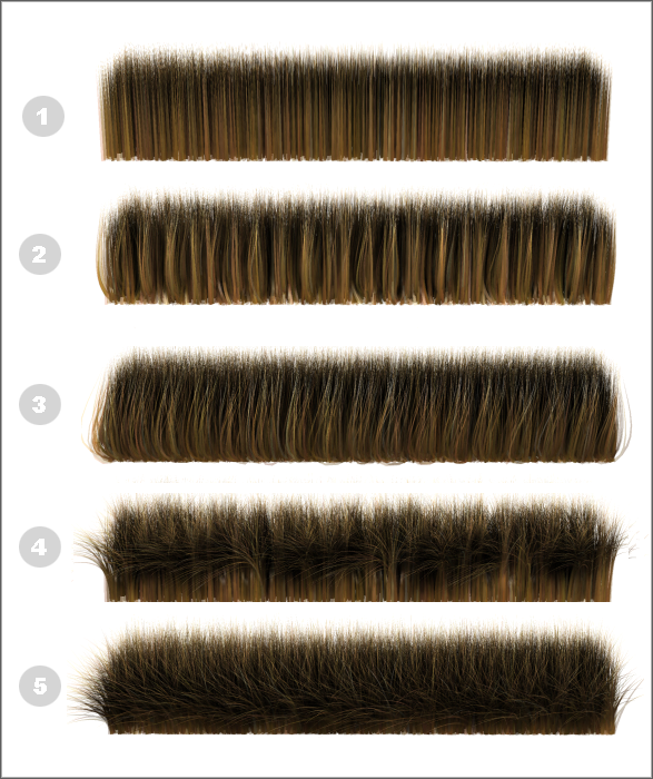

1. Frizz Root/Tip=0.0
2. Frizz Root=50.0, Frizz X/Y/Z Freq=14.0
3. Frizz Root=150.0, Frizz X/Y/Z Freq=60.0
4. Frizz Tip=30.0, Frizz X/Y/Z Freq=14.0
5. Frizz Root=50.0, Frizz Tip=100.0, Frizz X/Y/Z Freq=60.0

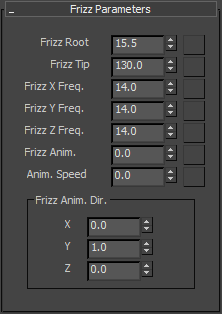

Interface
- Frizz Root
- Controls the displacement of the hair at its root. Default=15.5. Range=0.0 to 360.0.
- Frizz Tip
- Controls the displacement of the hair at its tip. Default=130.0. Range=0.0 to 360.0.

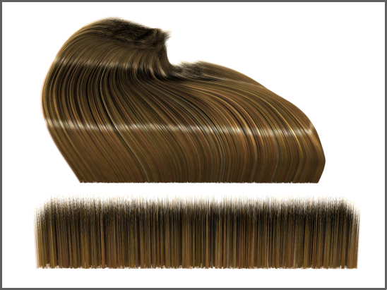

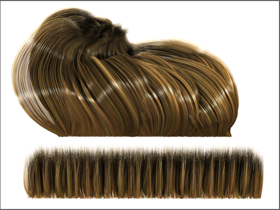

Frizz Root=30.0, Frizz Tip=100.0, Frizz X/Y/Z Freq=14.0
Top: Styled
Bottom: Unstyled
Left: Differing values for Frizz Root and Frizz Tip result in curved hairs.
Right: When Frizz Root=Frizz Tip, the hairs are straight.
- Frizz X/Y/Z Freq[uency]
- Controls the frequency of the frizz effect on each of the three axes. Default=14.0. Range=0.0 to 100.0.
Like frizz, Frizz Anim displaces the hair with a noise field. The difference is that you can move the noise field to create animated displacement, resulting in wavy movement without having to resort to dynamics.
- Frizz Anim.
- Sets the amplitude of the wavy motion. Default=0.0. Range=–9999.0 to 9999.0.
- Anim. Speed
- This multiplier controls the speed at which the animating noise field moves through space. This value is multiplied by the X, Y, and Z components of the Frizz Anim Dir attribute to determine the per-frame offset of the animating noise field. Default=0.0. Range=–9999.0 to 9999.0.
Frizz Anim Dir[ection] group
Sets the direction vector of the frizz animation. Default=0.0. Range=–1.0 to 1.0.
