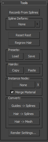

Interface
- Recomb From Splines
Lets you use a spline object to style the hair. Click this button and then select an object that is made up of spline curves. Hair will turn the curves into guides and populate each guide of the selected growth mesh with a replica of the closest curve.
This tool is particularly useful for creating a specific style and length, such as short hair with a part on the side, without having to manually groom the hair in the Style dialog. For optimal control, position the splines fairly closely together and use as many as possible.
Hair and guides are recombed by the spline object (white).
Spline Deform group
Spline deformation lets you style or animate hair by having it conform to the shape of a spline.
- Pick

Tip: One way to create a spline cage is to style hair, then click Tools rollout
Convert group
Guides -> Splines. - X
To stop using spline deformation, click the Clear Spline button (labeled “X”).
- Reset Rest
Performs an averaging of hair guides using the growth mesh’s connectivity.
This function is particularly useful after using Recomb From Splines. It's also advantageous when you change the size ratios of polygons in the growth object. For example, if you stretch part of the mesh by moving some vertices, by default the larger polygons will contain fewer hairs per unit area. Use Reset Rest to redistribute the number of hairs on the surface for more even coverage.

- Regrow Hair
Discards any styling information, resetting the hair to its default state, retaining all current Modify panel settings.

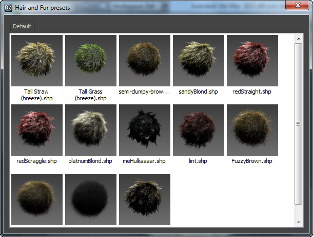

Presets group
Lets you load and save hair presets. Each preset contains all current Modify panel settings (except Display settings), but not any styling information.
- Load
Opens the Hair Presets dialog, which contains a list of presets in the form of named swatches. To load a preset, double-click its swatch. Several sample presets are included with 3ds Max.
Hair And Fur Presets dialog
- Save
Creates a new preset. You're prompted for a preset name; after entering one, Hair renders the swatch, as shown by a message on the status bar. You can abort the creation of the preset by clicking the Cancel button on the status bar during rendering. If you enter an existing preset name, Hair asks you to confirm overwriting the preset.
Hairdo group
Lets you copy and paste hairdos. Each hairdo contains all the current Modify panel settings (except Display settings) and styling information. This lets you apply all hair settings from one object to another.
- Copy
Copies all hair settings and styling information into a paste buffer.
- Paste
Pastes all hair settings and styling information to the current Hair-modified object.
Instance Node group
Lets you specify an object to use as custom hair geometry. The hair geometry is not instanced from the original object, but all hairs created from it are instances of each other, to save memory.
- Pick
To specify a hair object, click the Pick button and then pick an object to use. Thereafter, the button shows the name of the object you picked. To use a different instance object, or to use a modified version of the original object, click this button and then pick the new object.
Tip: In order for the instances to be properly scaled and fit to the hair, place the model's pivot at the “root” of the object. Hair will then scale your model appropriately so that the height of each instance matches the length of the hair it has been applied to. Any part of your model that extends below the pivot will intersect the surface. This can be useful; if the hair grows at an oblique angle to the growth surface, you can raise the pivot in the original model to make sure the instanced hairs will extend all the way to the growth surface.Also, bear in mind that the instancing engine will be deforming your model as it fits it to the hairs. Make sure that your model has enough divisions along the Z (vertical) axis for the deformation to look as smooth as it needs to; the number of subdivisions should be approximately equal to the Hair Segments value. Hair doesn't perform automatic subdivision on the geometry.
- X
To stop using the instance node, click the Clear Instance button (labeled “X”).
- Merge Material
When on, combines the material applied to the growth object and the material applied to the hair object into a single Multi/Sub-Object material and applies it to the growth object. When off, the growth object's material is applied to the instanced hair. Default=on.
Note: The merged material is instanced from the instance node, so that changing the original material affects the resulting material applied to the hair.
Convert group
Use these controls to convert guides or hair generated by the Hair And Fur modifier to 3ds Max objects that you can operate on directly.
- Guides -> Splines
Copies all guides to a new, single spline object. The original guides are left intact.
- Hair -> Splines
Copies all hairs to a new, single spline object. The original hairs are left intact.
- Hair -> Mesh
Copies all hair to a new, single mesh object. The original hairs are left intact.
- Render Settings
Opens the Effects panel and rollout and adds a Hair And Fur render effect to the scene, if one doesn't already exist.
Note: The Hair And Fur render effect settings are global, so even if you click Render Settings to open the effect settings from different Hair And Fur modifiers, you'll get the same render-effect settings.
